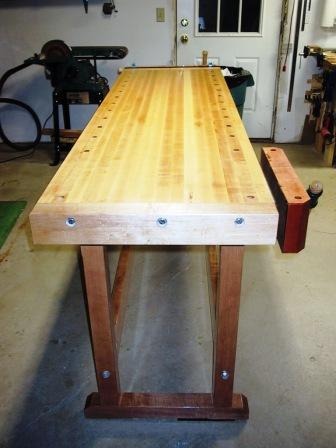

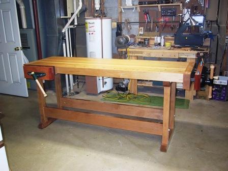

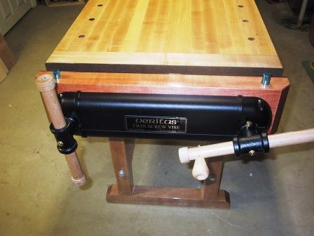

After months of nibbling away as time permitted, I finally completed the workbench. I built it from the Veritas plans provided by Lee Valley. I also got both vises from LV.
It's about 80" x 24" and 1.75" thick at the core...all hard maple. And hard it was...I must have sharpened plane irons every 15 to 30 minutes...and still got a few chipouts. It's finished in several applications of natural Danish oil for the benchtop and a cherry Danish oil on the vises for contrast. I also put a few coats of Polyurethane on the vises to add a little protection.
Check out the pics below:

Fantastic! Love that twin-screw vise - that will be extremely useful.

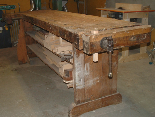

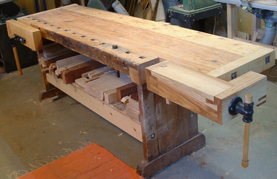

I brought an old bench that had a simple single screw type parallel tail vise back to life some years ago. The vise was very worn and would twist badly when I clamped things between the dogs; the bench has only one line of dog holes, so any clamping would be eccentric to the screw. I built a new, traditional drawer type vise and I designed it so the screw would be directly behind the dog holes to avoid any of these twisting forces. It has proved very sturdy and you can put a LOT of clamping pressure on it. I see your Veritas vise has two screws (and probably a lot more hardware than my old wooden one) so the twisting action might not be a problem when you use only one of the dog hole lines, but it was one thing I was concerned about when I build mine. Of course, you also have the added benefit of being able to clamp wide boards using two bench dogs in your vise, and that is something I miss.
Here's a "before" picture of my old bench:
And here's the "after" shot:

Johnny Cool...I've already resumed my keeper guitar and started putting the bench to good use. The vises are great for holding the recent neck carving jigs I made. Also, I'm re-doing a lot of my jigs so they can be attached to the bench by bolting them through the dog holes.

Serge...For me, every part was hard since I have such little experience... so I took great pains and a lot of time to think every operation through before executing. The most difficult part "would" have been getting all of the raw lumber cut to the dimensions of the plan. Since I don't have that kind of equipment, my Amish furniture-making friend did it in his shop. I helpled a bit where I could but he did all of the heavy work while I learned. So I drove home a truck full of partially dimensioned boards that required finessing and assembly. A few of my new challenges included:
1) Layout lines...I used a .5mm mechanical pencil and 3 Incra rules to get everything as perfectly square and even as I could. I measured 4 times before I cut or drilled anything.
2) Gluing up the core...gluing up the many 1.5" laminates was a challenge but drilling them all in 3 places for dowel locations helped ( I should have drilled for 5). I glued them in 3's and then glued those sections. We never have enough clamps so I borrowed a few.
3) Planing the surfaces flat and even was the most physical part of the project...I was literally up to my ankles in curls. Planing the ends of the cores taught me how to produce curls in end grain...scary sharp plane irons.
4) Cutting in mortise and tenons by hand is tough in maple. I drilled holes first to remove most of the material and establish the floor. Good, sharp mortising chisels are a must!
5) The vises were difficult from the standpoint that they had to have extremely precise holes drilled with large forstner bits...I was glad when that was over. The dog holes in the 6" vise jaws go all the way through...I had to drill from each side. Surprise...they actually met!!!
6) Drilling the long horizontal holes to meet up with the holes for the barrell nuts was scary at first. They had to be done with a hand drill... along with a very steady hand.
7) Routing the slots for the splines that align the end pieces to the core was a little harrowing but the use of a micro-adjusting edge guide made the difference.
Bottom line...if I charge for labor, I could have bought a similar bench a lot cheaper...but I'm glad I did the project.

Arnt...That looks very cool...I especially like the dovetail work. You're a true craftsman!
